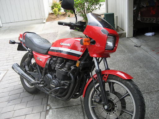

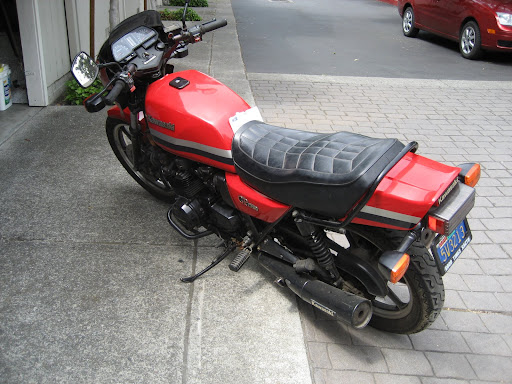

And here are some picks of the bike itself; I'll get some picks of the leaky carb up today:
1982 Kawasaki GPz 750
