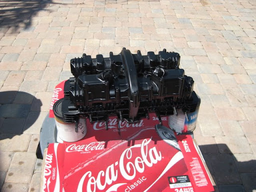

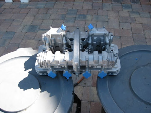

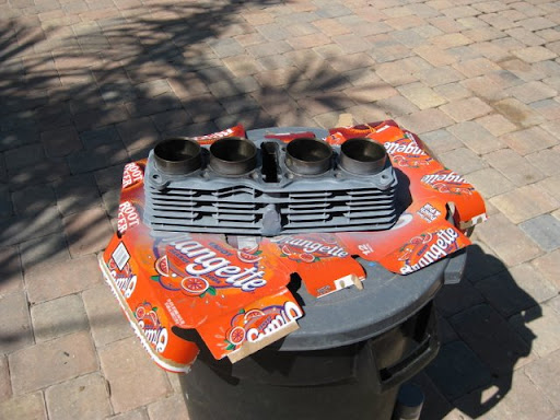

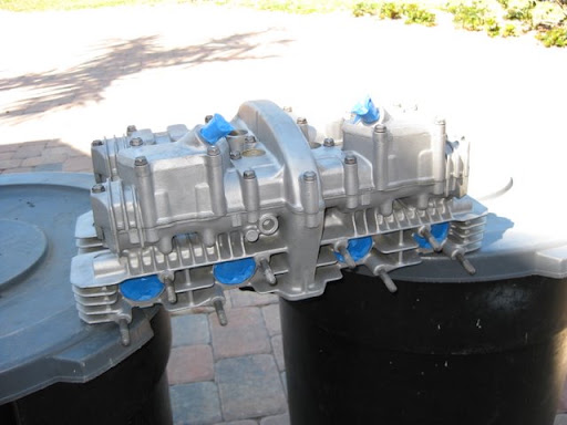

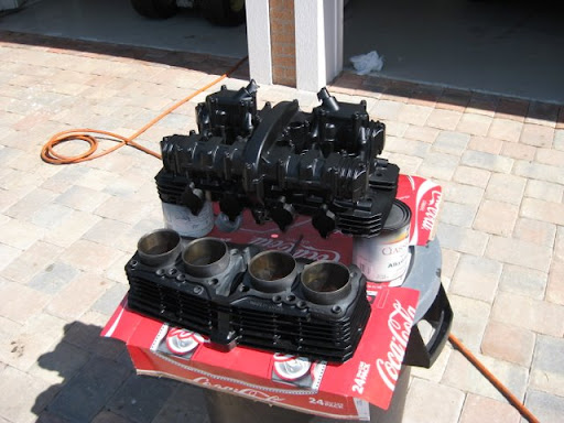

    The problem with plain untreated aluminum is how easily it absorbs dirt. That's go good for a bike ridden daily.
    Here are the pics:
    Dupli-Color Primer
    Dupli-Color Low-Gloss Black
    Both 500 Degree Capable
    Riding Vintage.
