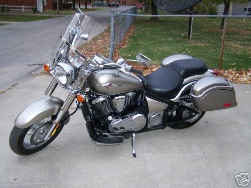

Recently bought me a 2007 Vulcan 900 classic, because the deal was just too good to pass up -
Heres the question - the bike came with no history and the owner is not available to talk to. All I know is that the bike came from SC, and has 1450 miles on it. I have no clue how hard those first 1450 miles were driven. It did not come with an owners manual, but I did purchase a PDF version of the shop manual. I would assume that these miles are on the original oil - and that the original oil MAY have been synthetic?? So, without any history, I want to go ahead and do an oil and filter change. Is it OK with this few miles on it to change to Mobil 1 V-Twin synthetic, or should I put a plain dino oil in for this first change (I prefer dino Rotella) thinking the rings and other components may need additional seating time?

That's a good looking bike.

Welcome nedley. Nice looking ride. I am sure Rich will pop in sometime today to give you a good answer.

Welcome! You got yourself a nice bike there. I had the shop do the 600 mile, and I did a change to Kawa 100% synth at 1000. I really like the difference with the synth. I would do a change now and go to the synth. I'm not sure any one filter is any better, but my dealer sells Hiflo filters (the HF303) fits the 900. It is a premium filter and costs a little more, but it has some "little extras" like a pre lubed "O" ring. Again welcome and you are going to love that 900.
