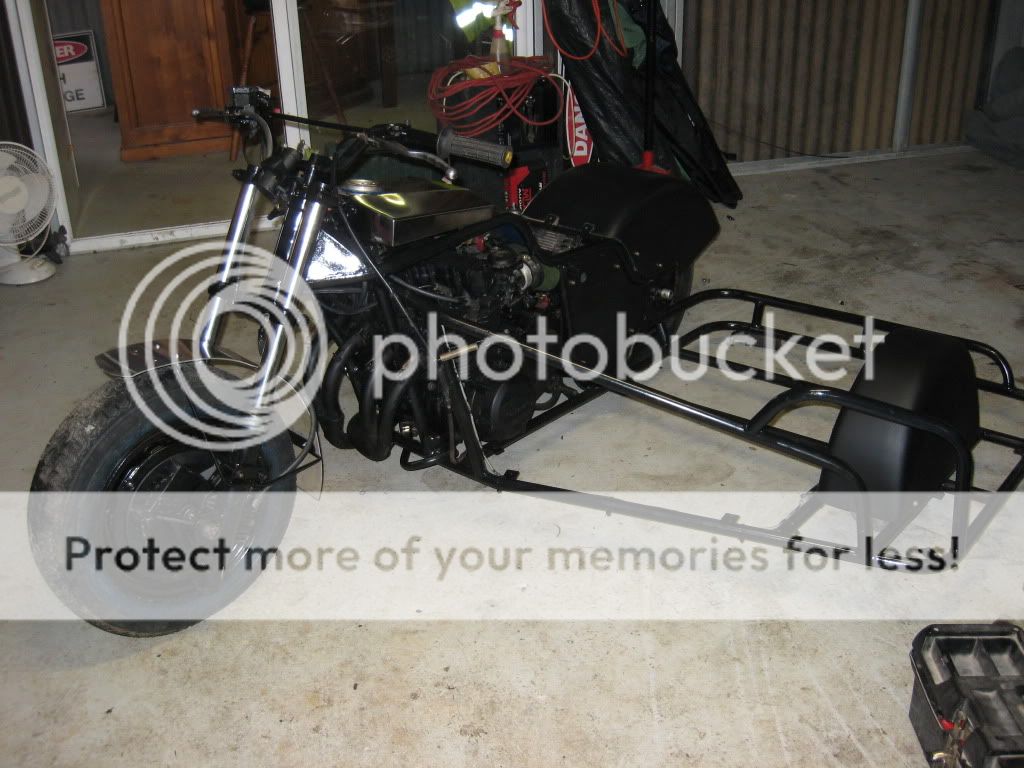

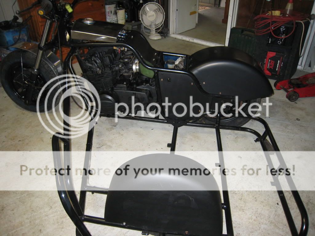

hi i have a 83 gpz550 engine in my custom sidecar racer (dirt)
when i accelerate it breaks down and miss fires a little but still climbs in rev's,
it gets alot better as it gets going, i am not to sure on what gap to set the plugs and or if i can check the timing.
the carbys did leak a little through the air filters once, maybe they are need of a service dose anyone know of any carby place's in penrith sydney NSW where i can get them looked at or if just a carby kit would sort my problems out,
any help would be most helpful as i wish to start practice 13/3/010
thank u..
