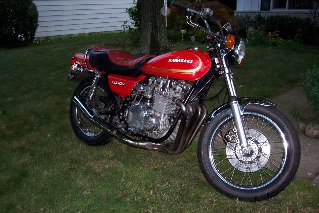

Does anyone know the years of seat pans that interchange on KZ1000's? I have a 78 KZ1000 with an LTD style seat and I want to switch to a flat style.
Anyone want to get rid of one?
Thanks

Thanks a lot, so I take it the seat looks pretty good too.
The first one says it is styled for 73-75 900Z1's, I would assume this is a different pan than my 78?
The one that says fits my 78 is $345. Yikes!

Thats not a bad price for a new seat especially compared to a corbin or other high end seat mfg's. Theres two other options you could look into. Shop ebay for an old flat KZ standard seat and recover it yourself. Or shave the foam on the seat you got and fit a standard cover to it. If youve never recovered a seat before, Its a real PITA if you dont know what your doing. Im glad I did mine myself and I would do again knowing what I know now. But about 30 minutes into the job, I would have happily paid $400 for a new seat!:eek:PS. As good as your bike looks, Id go for the new seat! Youll always be glad you did! :wink:

The seat will physically fit, but the latching system is different for a Z1 as compared to a KZ1000...I picked up a flat seat for my KZ1000A1 (1977..same latch as your 1978 ) from eBay and recovered it myself. They do come up periodically but not as commonly as the LTD seats do (like your current seat).

first one fits...just change out the latch...5 min job

Keith1: Thanks!! That is the kind of info I was looking for.
My bike looks good but it is far from great, faded paint,chips, etc. The pic makes it look good I will admit but a little misleading.
Bike Info: Wiseco 1105 kit, kerker header, and some fine tuning with turdy 28mm carbs.

I just called american classix and they said the first seat ($200) will fit the bike and the seat pan is even threaded for the U-bolt style latch. Awesome.
