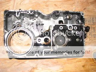

heres what I found when I pulled off the sump
Mostly blk silicone probably from the valve cover as the PO had gobbs of it on there
