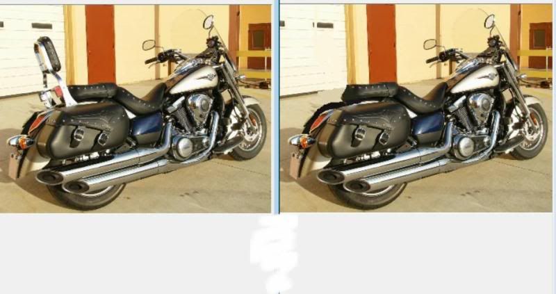

I'm going to get rid of the passenger backrest on my 1700 Classic LT. I have to make a couple new brackets and then it will be an easy switch. Just want to make it a little different than stock. I did some photo editing to give me an idea of how it will look.
Opinions?

Looks good. I like the look of bikes better without a backrest. Most the time I ride with a single Mustang seat with smaller side bags and ghost brackets. When the little lady is going for a ride I put the 2 up seat with backrest and the bigger bags on.

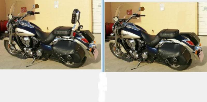

I have read over your dis-assembly instructions a couple times and it sounds like the 2 bikes are put together differently.
I have a bracket that bolts to each side of the fender. The bags mount to this bracket. On my bike, each bracket has a stub that sticks up. Each side of the backrest uses two bolts that mount to the stub.
I have already had it apart so that I could make up templates for the new brackets. Here is a picture that might help show how this thing is put together. Thanks, I appreciate the input.
