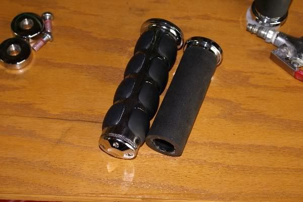

After I received the new grips I laid them out to make sure I had everything that was supposed to be in the package. Yep, left and right grip, spacer and a bottle of glue. Death Grip glue! Reminds me of the movie Death Race 2000. This stuff scared me so I used Gorilla Glue instead.

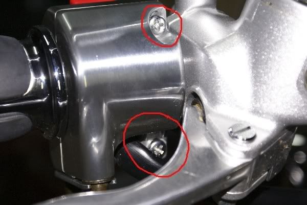

Now that the weights are off the rest of the project is a piece of cake. Remove the two screws (circled in red in the photo below) from the throttle housing.
Also, remove the screw on the bottom.

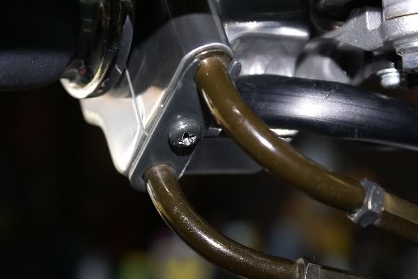

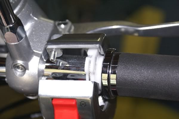

With the throttle housing separated you can see the two throttle cables. With a pair of needle nose pliers remove the two cables and slide the stock grip off.

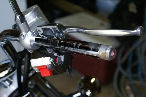

Your bike will then look like this.
This is a shot of the cable end of both the stock throttle grip and the ISO throttle grip.

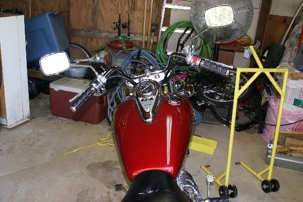

Slide the new throttle grip on and put the cables back in place. Replace the screws and tighten. Done with the right grip and it looks like this.

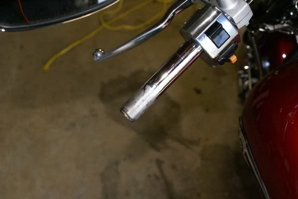

Now for the left grip. As this shot shows I was able to get the grip off in one piece. I ran a skewer (the kind you use to grill veggies or ka bob) between the grip and the handle bar. Then I used compressed air and a blow nozzle to just "lift" the grip from the bar and slide it off.
A little sandpaper to remove the old adhesive and it was ready for the new grip.

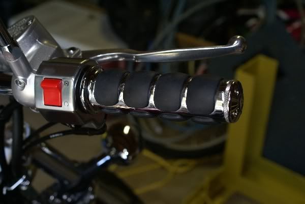

That's it. This is what how the bike looks with the new grips.

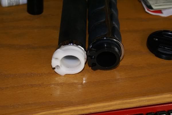

I bought new iso grip for my motorcycle...model 6240 1" universal medium lengh iso and for what I am looking at your pictures..mine did not bring the same things as yours... 1). as in your picture #6,..mine did not bring that black or white thing at the end of either one of the grips 2). it only brought one little black spacer that looks like a cylinder 3). and 2 tubes of glue.
I did notice that one of the grips inside dimension is wider then the other, so i guess that one is the throttle grip....
I am attaching pics so you can see how my grips came.
Can you please help me and tell me if there is anything missing or if i have the correct grips for my 07 Vulcan 900 Custom.also: I got the throttle boss and helmet lock for the end.

I bought the 6235 package. As far as I can tell you do not have anything missing. If you get the 6235 package you can follow the instructions I have outlined above. However, if you wish to use the 6240 you can but with a little more work. Follow the steps above until you have the stock throttle grip removed. Then follow these steps.
The photo below is the stock grip.
The two holes in the white plastic piece are for the throttle cables. This photo shows that the plastic piece is covered with the foam grip and goes from one end to the other.
You have to remove the foam from the grip. You will have to reuse the plastic piece so don't mess it up!
This shows the splines Romad filed off. (See the post right before yours) After the plastic is nice and smooth, put the new grip on with some glue. Like I said in my original post, I was scared of the Death Grip glue so I used Gorilla Glue. Much more forgiving. After you have the new grip glued together just continue to follow the instructions above.
