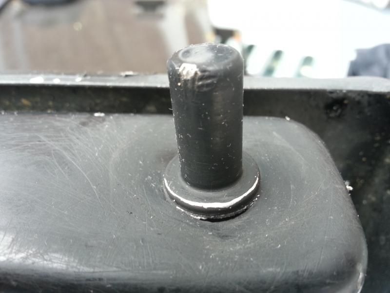

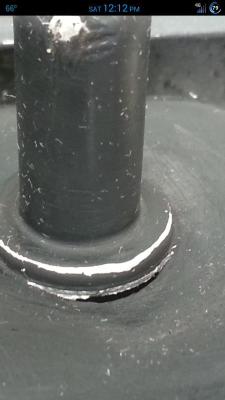

Has anyone had this problem? The rubber dampers that hold the radiator in place become worn, wallowed out, allowing the bottem front of the radiator to move forward slightly, causing the drain plug bolt/nipple to rub/vibrate against the crash bar and create a stress crack on the drain plug nipple at the base of the radiator. This is a 1600 vulcan classic.

I've got an o6 nomad. One of the lower welds on the fitting on the bottom of the radiator started leaking. Fortunately it had about 15 days left on the warrenty, and my dealer, where I purchased the bike new, replaced the complete radiator with a new one. About 3 weeks after that, the clutch went out. But, don't guess i can complain too much, as it has almost 100 thousand miles on it. ronnie

Both were leaking from the lugs on the bottom of the radiator where it is an obvious weak point. A mate of mine with a 1600 same problem. A pain but an easy fix take the radiator out a twenty minute job and give it to a radiator specialist. A pain for them to repair because the metal is so lite but it can be done

I've been smelling antifreeze for at least the last 2 years. Last year I did as you all said and tightened down the clamps. I still smelled it, especially at stop signs and red lights. My buddy and I looked at everything a couple of days ago and replaced the rubber grommets at the frame and placed the radiator back in. I guess the good news is I was still at his place and not 300 miles from home because all of a sudden it looked like Niagara Falls in his driveway after I started it up. Ran out of daylight so I rode his Gold Wing home (sure not used to that bike!). Anyway, for grins I called a Kawasaki dealer who told me a new radiator is $442. That motivated me to get over there today and pull it off and look again. Well, we found the problem. Chalking it up to poor design. Used JB Weld and so far so good.
