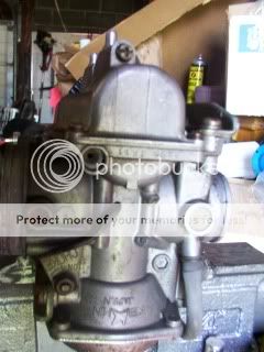

I have a 82 kz750 ltd 4 and I noticed that I had a fuel leak . The bowl seals look to be leaking and I notice that I was getting fuel on my right boot . I noticed that my 1 and 4 carbs has the fuel supply wholes open on the out side . I took a pic so you can see what I am talking about . The carbs are up side down . The whole I am talking about is just below the bowls in the pic . Should these be open like that or should they be capped off ?

Yes they are drilled out . As far as leaking I am tracking down all of the fuel leaks and I am thinking the right one is . My right boot gets damp with fuel and the left side of the motor / trans gets a good cleaning every time a took the bike out . I did find out that number 3 and 4 carbs has developed bowl seal leaks but I noticed that 1 and 4 had the out sided wholes . There has been a lot of hands into this bike over it 30 years life and I am thinking these are not the the carbs that the bike came with from the factory .

RoadRunner It does have a vacuum petcock . I did pick up some fuel that had a lot of trash in it . I have to replace the inline filter that I put on it in March . Between the fuel leek and the filter being almost plugged It would run for a while and then shut down . If you did get her going it would run week then shut down . I looked this afternoon and notice that there is left over glue around the wholes . I am thinking of using a small screw to block off the wholes and after I replace the bowl seals and the drain O rings I am going to try it out and if everything works then use a lite coat of epoxy around the screw heads just to keep them in place .

The nipples at the bottom of the carb bowls are the overflow ports. If fuel is leaking, there may be a problem with the float needle valves & seats: either there's debris keeping the valve tips from seating or they are worn/defective. Another cause for fuel leaks there is from a defective petcock or a petcock left in PRI while parked.

In this video the float & needle valve are in the lower right. youtube --- CV Carburetor
If crud gets between the needle valve tip & the seat, the carb will leak when parked.
